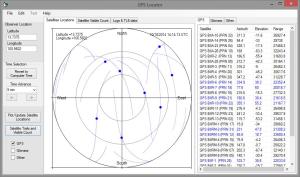

Some of you may be interested in a quick app I've put together, that runs from a Windows PC. Basically, it gives predictions of where the GPS (and Glonass) satellites are, to assist in deciding where may be the best place to locate your GPS antenna.
I'm not certain about the best way of sharing this, so I've shared it from a Google Drive, which you should be able to access from the following link.
https://drive.google.com/folderview?id=0...sp=sharing
Note this is version 1.0 release and hot off the press. Should be working OK. The ZIP file contains an EXE and a PDF file. The PDF files gives a quick summary of how to use it. Just put the EXE file anywhere and run directly.

At the moment, it is hardwired into the software so that it puts the TLE data on D:\ only. I guess this was a bit of programming short cut, but I can change to make this a user select-able option in a later update.
