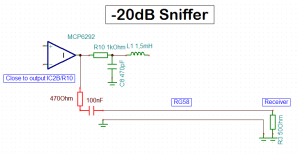

I've ordered a kit, and I've put together the loops. After testing them, I think I'd like to use them in my shack, which means I need to find a place on the board to pull the RF out. I was thinking directly after the first gain stage, before the signal gets to the filters. Is there an accepted method of doing this? I'm hesitant to pull the signal off the board directly into a coax to the shack, and thinking I'd better use a buffer amp. It'd be nice if a tried and tested method was out there, rather than reinvent a method.

Sorry, I wasn't sufficiently descriptive. I'm looking to pull out the RF off the antennas or off the amp board before the filter stages, so I can listen to the 30 KHz to 2 MHz segment. I figure this might be cheaper than buying a Wellbrook loop antenna. I'm mostly curious how to get the signal off the board without messing up the signal that goes to the controller board.

I suggest right after the HP-Filter.
Lower cutoff (-3 dB point) is 3KHz, and 50/60 Hz are attenuated significantly.
A 430-470 Ohm at that point is acceptable - this gives an attenuation of 20dB at the outlet.
Remember first stage amplifier ~ 0-30dB
Will we hear about the result? Wink

I don't want to be a spoiler - just take this as a warning if strange things happen:
For me the idea to split the VLF signal sounds like a potential source for unwanted common mode currents
resp. ground loops causing hum, noise and/or interference.

I would use a balanced amp. Opamps are cheap. With a balanced amp you are less likely to get in trouble with noise on ground since ground is not a reference potential. Ground noise can affect the signal you tap off, but worse is that it can sneak back into the BO system.
I'm a trouble shooter, and you would not believe how many problems we pin down to people believing that ground is the same in a system of connected devices.

To avoid ground loops, simply add a transformer on receiver site.
