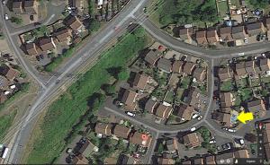

Here's a better picture showing the location of my house and the lines.

Hello,
As Tobias said, it is difficult to tell you if the station will work.
My station (733) is about 60m far from a powerline and it works fine (for me, maybe that the team would say not). I think that the voltage is 15kV (I can give that more accurately next week).
Maybe you can tell us more about that powerline. There should be some information on the pylon.

Steve's powerline looks like a 110kV (or maybe more) intercity powerline. Heavy isolators between the lines and the electricity pylon.
Looks not really good. It's try and error.

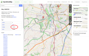

#14
Openstreetmap says 132kV. As Richo said, corona effects can be problematic, but they almost not present at this low voltage.

(2014-07-15, 16:48)RichoAnd Wrote: The corona can be a problem, so I would choose H-Field (Loop Antenna).
That in itself is good advice -thank you.
The map is interesting.
