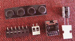

There are two boards.  The preamp board that I received last week (23.1) had two things to solder -- an RJ35 jack and a terminal strip.  Neither was SMT.  The main board that came with it (22.2) had two things to solder -- a big electrolytic and a terminal strip.  Once again no SMT.  Here is a snapshot of the entire solder-parts bag.
All surface-mount components had already been mounted for me.
And the firmware had already been loaded.

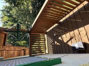

Yes me Ok8LEO . I have the mini. I noticed a bit disturbance when I am transmitting with 100 Watts on LF, MF, HF and VHF . the loop antenna is 60 meter away but I will invest where the disturbance comes from . The mini works good and no soldering is needed. On the picture you can vind the antenna temporarily fixed on the balcony. In the wite tight box there is an extension lead for the connection of WIFi extender , UBS connector and the receiver. outside the there is another box with the amplifier. This way I can play around in the garden where there WIFI and grid connection.  I am user 2444 and detector is 3179.
I hope this information helped abit to join the club
Leo

Ok8LEO, first thing I will do is shorten the wires between the loop and amplifier substantially. Less of an 'antenna' to pickup unwanted interference.
I can not tell from the pictures, make sure that you use a SHIELDED Ethernet cable, no longer than 30 meters,  between the amp and controller as per the published documents. Use a standard  UTP cable from the controller to your router or switch.

Thanks for your feedback . The Ethernet cable is a standard UTC cable with a length of 50 cm. I will shorten the antenna cable when the definitieve position is determend

Sorry I am not sure what "UTC" means in this context.  I imagine "U" might mean "unshielded" and if so, I would switch over to a shielded cable.
