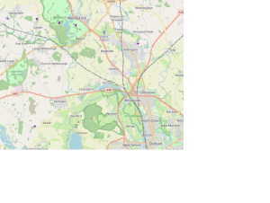

IF you use vector map on Blitzortung.org and mouseover & click a white stroke (approximately last 20 minutes - this function may vary)
![[Image: deviation.png]](https://frankfortweather.us/blitzblitz/deviation.png)
So, using the approximate 'discharge' speed (not 'speed of light') of 150km/sec, the error for THIS specific impulse is actually between .6km to 1.8km since we have an 'averaged' location for the ground point, outside the 'speed of light' assumed deviation of 1.2km. The ground point expected, theoretically, for this stroke, IF it is in fact a C-G impulse, should be within a 1.8km diameter circle of the plotted coordinates.... There are conditions that suggest IT COULD, in fact, be further away, or closer, depending on the actual characteristics of the impulse,etc., .. .and if the impulse is a C-C or I-C stroke, there will be NO ground point, and 'aerial' location may be vague or indeterminate at best, regardless of computed location. An impulse can be MANY miles in length!
