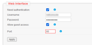

rutrut, that happens when you connect to the controller as a guest and not using authentication.
Have a look a the top left, there will be a 'Login' tab, enter a username and password then: (you might have to get it from the original owner)
Under Settings, go to Web Interface and remove the tick mark for Allow guest access.
Also, make sure you set a known username and password

#5
I must still be missing something here and I apologize. The previous owner was able to remove the system from his login giving me a new link in the web interface to register the device. That has been done and is now pointing to me.
However, I still cannot see any of the extra tabs in the web interface. The system is running completely in automatic with no way to adjust any of the settings.
The only tabs available are login ( which has no effect), settings ( nothing that can be configured), and about.
I never could get the screen showing that dupreezd mentioned above.
Getting closer, just need a little more info if one of you wouldnt mind
Thank You
