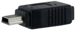

Why not buy an adapter. They have them in all sort of taste to connect whatever charge connector you have. They cost only some US$ 1 so don't make it to difficult or complicate.

(2022-02-27, 07:10)old_dutch Wrote: Why not buy an adapter. They have them in all sort of taste to connect whatever charge connector you have. They cost only some US$ 1 so don't make it to difficult or complicate.
Good point!  That would bypass the problem of many (most?) USB cables dropping the voltage too much to be usable, I could run a decent-quality cable as far as the adapter that doesn't create too much voltage drop.
