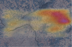

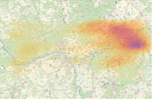

Hi,
I was looking for some hotspots in order to take pictures of lightnings (taking all possible security measure of course) and I could not find any good way of accessing to this information.
I wrote a script in order to extract the CSV data and to stich them temporally and I reprocessed the data afterward into Mathematica. Doing so I managed to generate the attached pictures.
For those interested in local density plot.
Below the script written in Python using the Selenium library. This script needs to be edited in order to perform your task, you need to define:
  • The location of your chromedriver
  • The download path
  • Your login on Blitzortung
  • Your password on Blitzortung
  • The start date for the data collection
  • The min/max latitude and longitude of the area of interest
