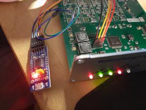

I make a short post to explain what happened to me recently. I bought a second hand station with programmed network parameters which were not suited to my network.  The consequence qas a steadily blinking network LED. I was not able to understand the underlying problem... because you need access to the embedded html server of the blue system in order to make a nice and easy diagnostic.
I then had a look at the forum and I could not find any hints, I then started on my own trying things. I resolved the problem (on linux but on windows it would be the same) by connecting a Serial to USB adaptator, see pic below.
I then tried with the moserial software to understand the message delivered by the blue system, to this end I had to adapt the communication speed between my computer and the blue system (config file for the moserial software is also attached to this post). I used a FT232 adapter from waveshare configured in 3.3 V.
The config file for the moserial is also reminded below:

I could then read the message provided by the blue system during the initialization phase (after reseting the system), see an exemplary copy of it:

This message showed me clearly that the system was looking for the wrong local network address, I had to change my local network address in order to fulfill the requirement of the blue system. Using this approach I could connect to my Blitzortung box though the router and reconfigure it properly. I switched on the DHCP and then I could manage having everything working.
