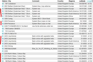

just looking at the UK station list here:
https://www.blitzortung.org/en/station_l...t_rows=100
I noticed a number of stations are listed as UK Country but 2-4 times in different Regions. is this a known bug?
[attachment=4443]

Some Stations are reporting in support of multiple regions. NOT a bug.
This is deliberate. This is assigned by the main servers. Also before someone asks again... the numbers for such stations are reported per/region, not a 'total' of 'all' signals from that station. Such stations must be checked by 'region', rather than just requesting a station number, expecting 'totals', etc.

Thanks for the update.
