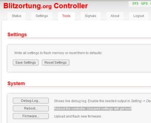

Can you post a screen shot?

This is what mine looks like

Mike-
The problem is that you have enabled "Need Authentication" under Web Interface in the settings tab and you are viewing the Status page as a guest - in other words you have not logged in to your controller yet so most stuff is hidden including the Device ID numbers you need.
To make this work, you need to press the Login link and then login using the username and password you created initially. Once you're logged in you will be able to view the Device ID numbers you need. Unless you specifically want to user that login facility, you can disable the "Need Authentication" . Most of us don't have it enabled as we don't have our controller's status page exposed to the internet using port forwarding.

Ok, now we're getting somewhere....Vk2him, you were correct...I know have the full list as described....
Seems, putting in the INCORRECT PASSWORD does not flag it as incorrect and I was assuming that I was actually logging in with the CORRECT PASSWORD....
Woke up at 1:45 in the morning still thinking about this and happened to get up and check this form and you guys came through....Thank You, Thank You.....but I'm going back to bed.....
