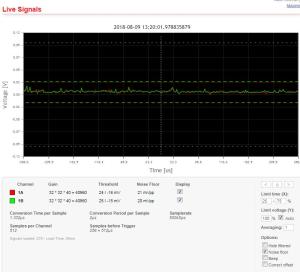

Hi i'm putting up a red system with loop antennas (shielded)
Stuff seem to work ish but i get a really low signal. amplification don't seem to change from either pot or from controller
looking at noise floor on different amplifications.

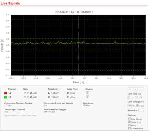

32x32
1x1

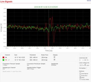

Ah that was the problem!
Now i have great signal! and amp levels do work.
so the "signal" i got earlier was only from the cat cable connecting to the amp.. :p

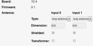

xztraz: A mistake in the diameter value of your loop antenna - 65mm is entered. It should be 650mm, I think.
Reply
#8
(2018-08-10, 13:43)kriu Wrote: xztraz: A mistake in the diameter value of your loop antenna - 65mm is entered. It should be 650mm, I think.
Ah mm it is. Fixed
no unit specified on input page

also turns. i think there should be a more visible explanation than a tooltip,
Stations: 2265
