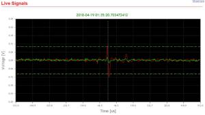

Very dead day lightning wise in region 3. Looking at three of the sites in NC, virtually no signals.

(2018-04-18, 01:03)BobW Wrote: Very dead day lightning wise in region 3. Looking at three of the sites in NC, virtually no signals.
Looking at the attachment it looks like Bear Creek needs some TLC!
Looks like you're chasing Interferers on Bear Creek... My environment gone to pot, especially diurnally, over last few months...
791 experimenting with H pol loops...  two of these are very irritating, especially since they oftern will NOT trigger interference mod.
Auto Amplitude is a very poor solution for me.. with some of these... .. Sigh.  this is going to be a long-term re-optimizing, or a

[Image: sigstest-XL.jpg]

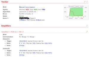

Actually, mine's pretty quiet.
No strikes, noise gate open
A strike someplace - probably South Mexico or Caribbean
Status page
The other three stations, low lightning = low signal count, which seems to be the way to go! Big Grin
Brian.
There is an electric fence pulse unit some 300 ft away that is on 24/7 so I get many signals from that.  I found the manual control adjustment range requires constant attention and I disabled the E field as it looks hopeless with the pulse noise.  I find that Tobi's auto adjustment methods are very under rated and produce a very good stroke rate.  The server is in control and sets the gains, sets interference mode and deals with the issues better than I can. So I don't win any awards for high efficiency but the stroke rate is what I base the detector performance on.
