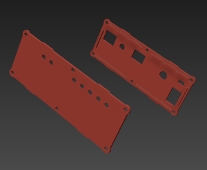

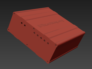

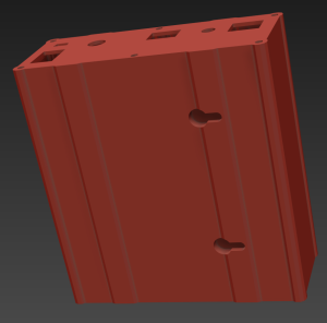

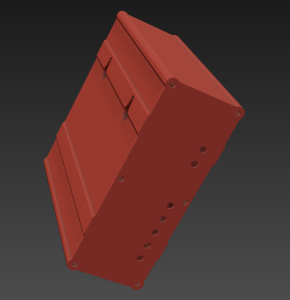

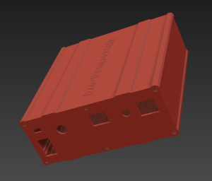

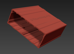

#32
Hello.
I developed a housing model for 3D-print. Today upload it on the thingiverse. The link will be a little later.
[Image: Y4cwh_-66Bs.jpg]
[Image: qK_rqqWDWqQ.jpg]
[Image: jC1cBBGmGeY.jpg]
[Image: Y3VHOQSICw8.jpg]
[Image: RsNIBZU9CVk.jpg]
[Image: _jn-2whOgHQ.jpg]

looks great, thanks for sharing  Shy

Housing was upload to ThingIVerse:
https://www.thingiverse.com/thing:3364124

Anton,
Wondering if you can share the build files. I've got an earlier model board, seems the back is different.
