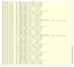

The debug log is repeating the following sequence over and over again.
2017-09-05 11:17:45    109 | GPS: 1PPS deviation too high 307330. Reset counter!
2017-09-05 11:17:45    109 | AMP2: Set gain 6 on channel 0, op-amp 0
2017-09-05 11:17:45    109 | AMP2: Set gain 5 on channel 0, op-amp 1
2017-09-05 11:17:46    110 | GPS: 1PPS deviation too high 267908. Reset counter!
2017-09-05 11:17:46    110 | GPS: Bad accuracy, resetting smoothing.
2017-09-05 11:17:47    111 | GPS: 1PPS deviation too high 249264. Reset counter!
2017-09-05 11:17:47    111 | GPS: 1PPS inaccurate! Counter is 44268950, should be around 84000000
2017-09-05 11:17:49    113 | EVENT: GPS 1PPS counter is accurate again.
2017-09-05 11:17:49    113 | GPS: 1PPS OK
2017-09-05 11:17:50    114 | GPS: 1PPS deviation too high 40448537. Reset counter!
2017-09-05 11:17:50    114 | GPS: 1PPS inaccurate! Counter is 43500712, should be around 84000000
2017-09-05 11:17:50    114 | REMOTE-CONFIG: Server '2' deactivated
2017-09-05 11:17:50    114 | REMOTE-CONFIG: Server '2', expert '0'
2017-09-05 11:17:50    114 | REMOTE-CONFIG: Server '2' activated
2017-09-05 11:17:50    114 | REMOTE-CONFIG: Server '2', expert '1'
2017-09-05 11:17:50    114 | REMOTE-CONFIG: Done with 5 updates and 0 errors
2017-09-05 11:17:52    116 | GPS: 1PPS OK
2017-09-05 11:17:55    119 | AMP2: Set gain 5 on channel 0, op-amp 0
2017-09-05 11:17:55    119 | AMP2: Set gain 3 on channel 0, op-amp 1
2017-09-05 11:18:00    122 | RTC: Setting RTC from GPS time, time difference was -2s
2017-09-05 11:18:06    128 | ADC: Watchdog is pending since 2s (0x25 0x24 0x24) -> RESET -> (0x24 0x24 0x24)
2017-09-05 11:18:06    128 | REMOTE-CONFIG: Server '2' deactivated
2017-09-05 11:18:06    128 | REMOTE-CONFIG: Server '2', expert '0'
2017-09-05 11:18:06    128 | REMOTE-CONFIG: Server '2' activated
2017-09-05 11:18:06    128 | REMOTE-CONFIG: Server '2', expert '1'
2017-09-05 11:18:06    128 | REMOTE-CONFIG: Done with 5 updates and 0 errors
2017-09-05 11:18:07    129 | ADC: Watchdog is pending since 3s (0x29 0x28 0x28) -> RESET -> (0x28 0x28 0x28)
2017-09-05 11:18:07    129 | AMP2: Set gain 5 on channel 0, op-amp 1
2017-09-05 11:18:08    130 | ADC: Watchdog is pending since 4s (0x25 0x24 0x24) -> RESET -> (0x24 0x24 0x24)
2017-09-05 11:18:12    134 | REMOTE-CONFIG: Server '2' deactivated
2017-09-05 11:18:12    134 | REMOTE-CONFIG: Server '2', expert '0'
2017-09-05 11:18:12    134 | REMOTE-CONFIG: Server '2' activated
2017-09-05 11:18:12    134 | REMOTE-CONFIG: Server '2', expert '1'
2017-09-05 11:18:12    134 | REMOTE-CONFIG: Done with 5 updates and 0 errors
2017-09-05 11:18:18    140 | AMP2: Set gain 6 on channel 0, op-amp 0
2017-09-05 11:18:18    140 | AMP2: Set gain 2 on channel 0, op-amp 1
2017-09-05 11:18:28    150 | AMP2: Set gain 5 on channel 0, op-amp 1
2017-09-05 11:18:39    161 | REMOTE-CONFIG: Server '2' deactivated
2017-09-05 11:18:39    161 | REMOTE-CONFIG: Server '2', expert '0'
2017-09-05 11:18:39    161 | REMOTE-CONFIG: Server '2' activated
2017-09-05 11:18:39    161 | REMOTE-CONFIG: Server '2', expert '1'
2017-09-05 11:18:39    161 | REMOTE-CONFIG: Done with 5 updates and 0 errors
2017-09-05 11:18:40    162 | AMP2: Set gain 5 on channel 0, op-amp 0
2017-09-05 11:18:40    162 | AMP2: Set gain 4 on channel 0, op-amp 1
2017-09-05 11:18:45    167 | REMOTE-CONFIG: Server '2' deactivated
2017-09-05 11:18:45    167 | REMOTE-CONFIG: Server '2', expert '0'
2017-09-05 11:18:45    167 | REMOTE-CONFIG: Server '2' activated
2017-09-05 11:18:45    167 | REMOTE-CONFIG: Server '2', expert '1'
2017-09-05 11:18:45    167 | REMOTE-CONFIG: Done with 5 updates and 0 errors
2017-09-05 11:18:50    172 | GPS: Receive OK
2017-09-05 11:18:50    172 | EVENT: GPS data check ok.
2017-09-05 11:18:50    172 | GPS: Everything OK
2017-09-05 11:18:51    173 | REMOTE-CONFIG: Server '2' deactivated
2017-09-05 11:18:51    173 | REMOTE-CONFIG: Server '2', expert '0'
2017-09-05 11:18:51    173 | REMOTE-CONFIG: Server '2' activated
2017-09-05 11:18:51    173 | REMOTE-CONFIG: Server '2', expert '1'
2017-09-05 11:18:51    173 | REMOTE-CONFIG: Done with 5 updates and 0 errors
2017-09-05 11:18:51    173 | AMP2: Set gain 3 on channel 0, op-amp 1
2017-09-05 11:18:57    179 | REMOTE-CONFIG: Server '2' deactivated
2017-09-05 11:18:57    179 | REMOTE-CONFIG: Server '2', expert '0'
2017-09-05 11:18:57    179 | REMOTE-CONFIG: Server '2' activated
2017-09-05 11:18:57    179 | REMOTE-CONFIG: Server '2', expert '1'
2017-09-05 11:18:57    179 | REMOTE-CONFIG: Done with 5 updates and 0 errors
2017-09-05 11:19:04    185 | REMOTE-CONFIG: Server '2' deactivated
2017-09-05 11:19:04    185 | REMOTE-CONFIG: Server '2', expert '0'
2017-09-05 11:19:04    185 | REMOTE-CONFIG: Server '2' activated
2017-09-05 11:19:04    185 | REMOTE-CONFIG: Server '2', expert '1'
2017-09-05 11:19:04    185 | REMOTE-CONFIG: Done with 5 updates and 0 errors
2017-09-05 11:19:06    187 | AMP2: Set gain 6 on channel 0, op-amp 0
2017-09-05 11:19:06    187 | AMP2: Set gain 5 on channel 0, op-amp 1
2017-09-05 11:19:14    195 | REMOTE-CONFIG: Server '2' deactivated
2017-09-05 11:19:14    195 | REMOTE-CONFIG: Server '2', expert '0'
2017-09-05 11:19:14    195 | REMOTE-CONFIG: Server '2' activated
2017-09-05 11:19:14    195 | REMOTE-CONFIG: Server '2', expert '1'
2017-09-05 11:19:14    195 | REMOTE-CONFIG: Done with 5 updates and 0 errors
2017-09-05 11:19:16    197 | AMP2: Set gain 5 on channel 0, op-amp 0
2017-09-05 11:19:16    197 | AMP2: Set gain 3 on channel 0, op-amp 1
2017-09-05 11:19:26    207 | AMP2: Set gain 6 on channel 0, op-amp 0
2017-09-05 11:19:26    207 | AMP2: Set gain 5 on channel 0, op-amp 1
2017-09-05 11:19:34    215 | ADC: Watchdog is pending since 2s (0x25 0x24 0x24) -> RESET -> (0x24 0x24 0x24)
2017-09-05 11:19:34    215 | REMOTE-CONFIG: Server '2' deactivated

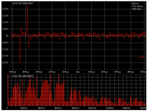

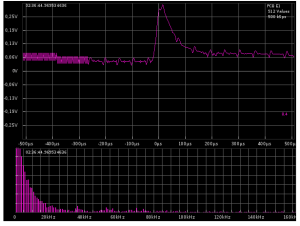

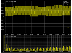

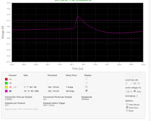

The signals, see:-
https://www.dropbox.com/s/ptqxgiuhulrxpm...8.png?dl=0
Again this seems to keep repeating this strange waveform and the numbers are just leaping about randomly.

Hi again, There is not a short on the coax.
The E-field board has a BAT54s (two zener diodes) on the antenna side and they are both intact and they are in parallel with the red led that goes to ground via  a 2.2k resistor on the output side to the main board the red led still lights up. The 3.3mh inductor on that board is also O.K. therefore I think pcb_17.1 has survived.
I have tried using the different channels one by one with the rest disabled, the results while different are not what one would expect on any of them.
Both pre-amps do appear to function. I still think it is pcb 19.c?
I will have another look at the main board tomorrow, there are four identical channels for the most part, maybe I will get lucky and find something easy to replace! ;-)
O.K. After a very late night, I had another look this morning and I am loath to start swapplng things about, after my tests on the individual channels I think the problem
is with the logic or micro-controller, both of which are beyond my pay-grade.
I have written some ideas below.
Brian. Sad

O.K. I have switched back to version 8.2 but the status on the map page still says 8.3b. so there still seems to be a fault with the communication.
I was only running for a short while, but, as you can see, very little has changed.
It does seem that the E channel is not going negative and the other two are just generating garbage interference.
I will have a another go at it tomorrow. Huh
Brian.
