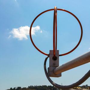

For example, LINET system uses loop antennas and can detect all types (and other data) of discharges: CG, IC, polarity and lightning current values.
Below antenna for LINET system.

#8
Kriu,
you are right: they use only the loop antennas. The webpage of the company is: https://www.nowcast.de/.
The high accuracy of their detection (they claim 100 m to 75 m) allows them also to check for the height of the discharge, but I am not sure what their efficiency for intra- or inter cloud lightning really is - what do they use as reference??
Anyway, this appears to be the best current system for lightning detection.

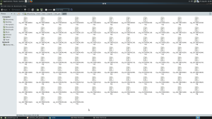

It will pass some time until I can mount a E-field antenna on my system red in Romania, but I just started deploying a linux-based virtual machine where I can do some tests.
For now, I started downloading the signals from all red and blue stations in Germany (to record at least 2-3 days of signals and strikes) and will start analyzing the strikes/signals with Tobi recommendations.

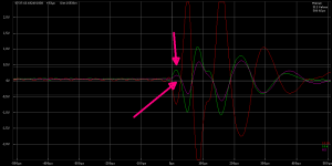

I have received a signal from a lightning which saturated one of the H channels. Data from the european lightning detection network EUKLID could be correlated with this ligthning, it was a very strong negative lightning with -144 kA strength. The E field channel (magenta trace) goes POSITIVE in the first peak of the signal, so this is the signature for negative CG lightning. Positive CG lightning will first go negative in the E field channel.

(2017-08-28, 09:45)pasense Wrote: I have received a signal from a lightning which saturated one of the H channels. Data from the european lightning detection network EUKLID could be correlated with this ligthning, it was a very strong negative lightning with -144 kA strength. The E field channel (magenta trace) goes POSITIVE in the first peak of the signal, so this is the signature for negative CG lightning. Positive CG lightning will first go negative in the E field channel.
That would be an interesting observation... if it proves consistent. Using the attached correlation E with Channel C ...(E signal in phase with A and B, trust me,)  which of the following random "sferics" might be "Positive" sferics? Rolleyes Why?  (Just assume they're all strokes, not junk)...

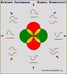

Exactly.... and which channel is referenced for phasing?
[Image: evsh.png]
http://onlinelibrary.wiley.com/doi/10.10...10294/full
Positive Ground strokes tend to single discharge events... negative tends to multiple discharges. even tthat rule of thumb isn't always valid....

I used the very beginning of the signal, so this cannot be a reflection which is contributing only later to the signal. The line of sight from the station to the stroke was only over the sea, so the ground wave had little attenuation. I will try to get the opinion of lightning location specialists on this topic (identification of polarity for distant strokes).
Cutty, there was another stroke only 40 msec later at the same postition, so this is consistent with a negative stroke. Positive CG has only very rarely a second stroke at exactly the same position. A problem with +CG is that these waveforms are more complicated than -CG because very often there is significant cloud discharges before the return stroke. Sometimes this even leads to strong +CG not being identified correctly, instead a cloud discharge is assumed by the system.
