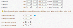

Hi Joe: Yes, we are relatively close, and I also see another station near you. I do not have an E-field antenna, so I disabled AMP 2 (which apparently was enabled by default). I have not changed anything else since I went online yesterday. Here is the page with what I assume are the gain controls. Do you have recommendations as to what changes I should make, and if there are other pages to modify? How do you see what interference levels I have?
Thanks, Steve (N2QLQ)

#8
(2017-08-18, 22:18)SteveQlQ Wrote: Joe: hopefully, I have a file attached to this ....
Hey Steve. I have adapt to noise enabled, for me, it seems to make the strike count go up. My gain is 8*4, 8*4, but that might not work for you. Just mess with it till you get good ratios. You do look like you have some noise to figure out. I have an LCD tv that makes my signal look like yours from wherever I put the antenna. Dimming switches and cfl or fluorescent bulbs also make noise. I just recently had bad interference and I turned off the HP filter and it went away. But it was a spike, not constant like yours.
And I think you do have to go to the page linked in my last post to enter in your antennas, and the length. I read here somewhere it has to be entered. Looks like the attached picture.

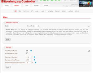

#9
I didn't see if you changed out of auto or not, if not, you can always try it here:
Attached Files Thumbnail(s)
Stations: 1955

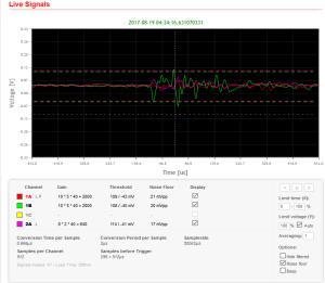

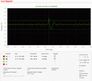

Joe and Kevin..I moved my antenna about 10 feet from where it was and changed the gains to 8x4, 8x4 just as an experiment, and this is a capture of the live signals. Does this look better? Would you send me a copy of yours, so I can make a comparison?
I am using a 1 AMP wall wart from an unused Raspberry Pi. If you think there may be a better one, please let me know brand, model, etc., and I will replace it.
Thanks again.

(2017-08-19, 03:10)SteveQlQ Wrote: Joe and Kevin..I moved my antenna about 10 feet from where it was and changed the gains to 8x4, 8x4 just as an experiment, and this is a capture of the live signals. Does this look better? Would you send me a copy of yours, so I can make a comparison?
Thanks again.
I think it looks pretty good. I don't know why you aren't picking up more strikes. You can probably bring the gains up some if you want, you can always bring them back down if you go into interference.

#13
Much improved. That 70-75 kHz interference is now gone.
That interference was really strong before.
You can click the Station number in the bottom of our posts and see the signals we are uploading.
There are small compression squiggles in the images, just ignore that.

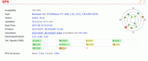

One more question for you SteveQlQ.
Is your GPS locked on?
How many Satellites does it say you are tracking?
Kevin McCormick KB0UOI
Macomb, IL USA
Stations: 1539

Kevin, thanks for the PS recommendation. Attached is the GPS info at the time I wrote this:
Steve
Stations: 1964

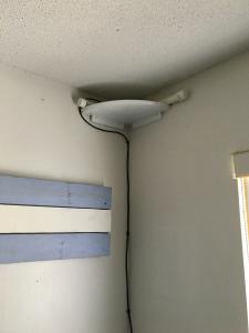

(2017-08-19, 12:38)SteveQlQ Wrote: THANK YOU ALL!!..After implementing a number of your suggestions, I now seem to be getting some legitimate strike data. I will do some sniffing for interference as mentioned by Eric, and I know I will definitely have to move my antenna assembly where it is just sitting on top of a bookshelf.
I appreciate everyone's help. I know my signals still are not as "pretty" as some, but as a friend says, "If it's stupid and it works, it's not stupid!" Once I move the antenna, I will start playing with the parameters again. Unfortunately, I live in a noise rich area, and who knows what will happen when I use my ham transmitter (with an attic antenna...damn HOA's).
Steve N2QLQ
This morning you're getting good signals! I'm still working on my optimal setup, hopefully I get it nailed down soon.
My antenna is in my back bedroom, mounted high and seems to work pretty good there. Smile

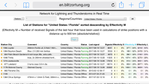

Btw, at the moment, you're ranked 2nd in the state for effectivity! Smile
http://en.blitzortung.org/station_list.p...t_rows=100
