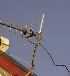

E-Field went in yesterday, about 150mm from memory.

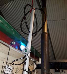

First attempt at making a H-Field was completed a couple of hours ago.
To get started I make a 4 turn Moebius Loop with RG6 Coax.
It's just hanging in the outdoor area ATM & plan to re-site everything later in the week.
Right now the GPS is  shaded by a double iron roof.
Don't mind the idea of building another, better H-Field, but at least it's going now.
Any advice will be greatly appreciated.

You should install the H-field pre-amp closer to the loop.
The cables should be a little shorter.

Is the loop antenna near the metal pipe? - is it a chimney?
If so, I suggest move a little away from this metal pipe.
I also suggest to attach a coaxial wire from the E-field antenna to the mast.

Yes, a heater flue. Not it's final location yet, need advice on that.
Also needs the Coax to the Amp tidied up & shortened.
I should maybe have mounted the junction box higher, it's currently 200mm below the loops.
Quote:I also suggest to attach a coaxial wire from the E-field antenna to the mast.
The TV antenna is not used, so it can be removed to help improved the E=field install,

the roof of corrugated iron will shield the loop antenna quite well, so when you place it on top of the roof or somewhere outside the H signals will go up considerably. The E signal appears to have a quite high noise of higher frequencies; maybe a filter would help. If you can find the source of this noise and remove it, it would be better but that may be hard to achieve.
