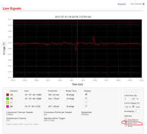

To narrow down where your external noise is coming from try going to the signals page and set it to display only signals from one of ferrite loops. Check the Noise floor box.
Like so:
Slowly rotate the ferrite in the horizontal plane while watching the noise floor level. When you are pointing directly at the noise source you should see a null point or at least a point where the noise is significantly reduced.  The null point will be off the ends of the ferrite. So if you have the ferrite oriented north-south the strongest sferic signals will be received from east-west or broadside.  If the noise source is north or south is will be nulled or attenuated when the ferrite is pointed directly at it.  The null point can be quite narrow. If you have multiple noise sources then things become more difficult.  Dodgy
Like so:

Try playing with:
The tick box next to "Noise Floor".
The tick box next to "Auto Refresh".
The <, O and > boxes.
Cheers
Dave.
