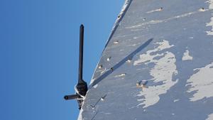

thank you very much for your comment, two antenna attached each other with tape 90 degrees angle (sea attached picture), I have placed antenna to top of non-working satellite dish towards to round area of dish, could it be the reason of signal quality? and there are some air-condition engines are approx. 3 meters away from the antenna, but you mentioned that only Ch1A is effected that confused me.

Is one of those ferrites vertical? As I understand it they both ought to be horizontal. I have 3 loops, 2 vertical and 1 horizontal the horizontal loop produces a very different siganl to the vertical ones, much like your first channel. Note: Loops operate "opposite" to ferrites.
I hope you used something like self amalgamting tape to make the antenna assembly, ordinary insulation tape won't keep the damp out, don't forget the free end either. Being creative with solvent weld plastic waste water pipe and fittings, T peice, stop ends and access caps may be better, have search for what others have done for ideas.

they both horizontal, do I have to place one in vertical and other is horizontal? and attaced Taype is normal electrical used tape, thank again for support I will do some modification,

Both horizontal is how they should be, must be the angle of the photo. I wonder if the metal of the dish is affecting things, is it steel? Where is the pre-amp? That needs to be close to the ferrites.
Looks like you've had a fiddle, a very quick look showed much more consistent signals and I think your LMO "Locating Ratio" has gone up.
