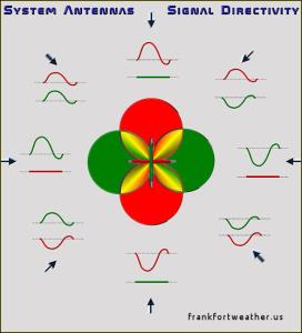

The polarity doesn't matter for the Blitzortung system.  This is a TOA / TOGA system, and all it needs is stroke impulse data. The polarity would matter if this were a DF locator, which it is not.  It's good to keep 'consistent' however, since it is possible, if you do everything correctly, (Same polarity, Correct physical orientation) using two ferrites at 90° to 'eyeball' the direction of a signal on local signal display...e.g. attached.... which can help track down "interferers"
