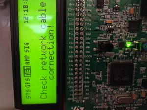

After 18 minutes , all ok , look the photo.
tks

#5
There seems to be a memory allocation problem. It's not directly related to the network connection. I will investigate.
PS: Please leave the station running this way! Thanks!

after ten minutes, on the display: Check network cable connection... networks down...

#10
The problem occurs only when the station is registered for more than one region in combination with compression. It will be fixed in the next firmware.
