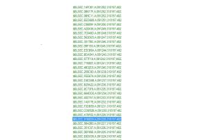

i had System Green PCB 6 Version 3 Firmware 22 running
GPS Grarmin 35 LVS
I moved the Station into another room and had to extend gps wires
Everything looks good but Windows Tracker is Stuck at Reinitialize GPS (20)
I receive the GPS Data but Windows tracker keeps logging
1970-01-01 00:59:59 Wrong Timestamp
but the GPS Data looks good:
(see attachment)
Any ideas ?
Edit: I noticed that the date from the GPS seems to be wrong indeed: 31.01.1997 (why that??)

Hi folks i fixed it myself. It was a wrong dateformat setting wthin the gps .. I dont know why but it works fine after i set it to the correct time date format.
