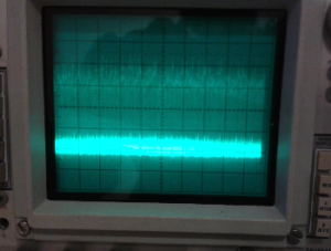

Not being one to give up easily and having solved or come to conclusions on the action required for the noise problems decided to revisit the TL-POE10R PoE splitter. Prised the case apart (four broad clips about 1/8" from the ends on the long sides). The pass through ethernet (all four pairs) is galvanicly isolated with a HST-24001SCR 1:1 isolator. Couldn't quite work out what was going on on the DC side. I don't think it is truly isolated but there is some separation. Pretty sure the output ground is not directly connected to the DC-DC convertor ground. The output has a 470 uF electrolytic capaciitor across it.
Anyway used the TL-POE10R to power the system and it was just as bad as before. 'Scope showed strange wave form of about 100 mV p-p and a frequency of about 40 kHz on the power supply rails. During my research into noise I'd come across RichoAnd's power supply filter (https://forum.blitzortung.org/showthread.php?tid=1802).
Having a couple of unknown ferrite toroids(*) and small reel of enameled copper wire wound 60 turns around each one (40 mm dia 5x5 mm cross section approx). Popped those in series with each power leg and most of the horrible noise had gone. The system wasn't happy though, roughly every second it would register a "strike" and there would be a simultaneous burst of noise on the power supply rails. Adding a 0.1 uF capacitor across the output side of the two toroids, cleaned things up even further and the rogue "strikes" disappeared.
System still not happy though but then it was only getting 4.2 to 4.3 V. The wire I used for the toroid windings was not very thick and there was a drop of about 0.5 V across each one. I didn't find the load resistor did anything useful other than get warm and ensure that the PoE splitter started up if the system board was disconnected.

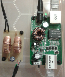

Bought another TL-POE10R and capacitors (2 x 0.1 uF 50 V ceramic, 1 x 100uF 25 V electrolytic) from Maplin, the caps take the purchase into the free P&P range. Chokes from Amazon but an add on item that has gone up 50p each since I bought mine, 220 uH, 4A and made made up a small PCB(*) to mount them on. Works a dream. Smile

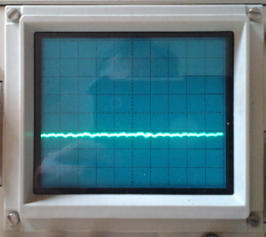

'Scope images, input has  just over 100 mV of noise as before, output less than 10 mV of ripple. Both images taken with the 'scope set at 20 mV/div and 2 ms/div. Controller is now reporting a much healthier 4.9 Volts input and is quite happy. No noticeable noise being received either. There are still some quite large spikes/dips that follow the GPS LED and RJ45 data LED flashes but nothing seems to be objecting. I did try adding another 100 uF of capacitance on the filter output, made no real difference. Circuit is chokes in series with each power line, 0.1 uF across the input and output sides of the chokes and the 100 uF across the output side.
Checked for voltages between house supply earth and the 0 V rail, 38 V 50 Hz. Very variable and joining the two together through an ammeter gave a whole 20 uA of current flow and the volts disappeared, not going to worry about that. Worth bearing in mind and checking out if the PoE injector used is earthed (mine isn't). Adding the ground connection didn't make any difference to received noise levels, whether it improves signals is for later.
(*) I actually made two boards. It was going to be four as that is how many fit across the bottom of a sheet of "press 'n peel" but the guillotine found it harder to cut than I expected... A PDF of the layout is attached. The board is symmetrical, there is provision for 2 components across each side of the chokes. When fitting the chokes try and work out which wire is the "start" and put that in the same shaped pad for each choke. In theory any stray magnetic fields from the chokes cancel rather than couple.

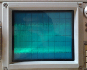

This PoE splitter doesn't need any help to make noise. Here is its output when loaded only by a 100R resistor. Slightly lower in level but it's only got a 50 mA load, the other image was taken with the 350 mA or so of a Blue controller as load.
