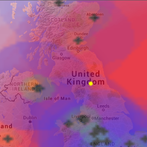

Yellow blob on the attached map, borrowed from www.lightningmaps.org, [url=http://www.lightningmaps.org/realtime][/url]is about where the station would be. Looks like it would nicely fill a gap and improve coverage of the east side of northern England. The location is at 1400' and fairly exposed, so I'd expect it to have quite a range.
Does this make the station "very special" and give a priority in the next batch of boards?  Well you never know...

(Waves from a bit further South in Warrington)
Who knows? You could try grovelling nicely to Egon!
Looks like a good spot. I have a Blue on order, was thinking of trying to move my Red to a family member in North Yorkshire at some point. How close to Anthorn 60kHz tx would you be? I don't get much of that but I seem to get a lot of Inskip 81kHz.
