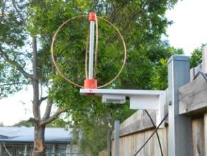

(2016-08-11, 06:31).RichoAnd Wrote:
(2016-08-10, 12:11)bazzalight Wrote:
(2016-05-31, 21:30)RichoAnd Wrote: Richo,
I have started making the H field Copper tube Loop antenna shown in your mini guide and also from http://users.skynet.be/DanielV37/Project...m#Hardware.  I have produced 3D print files for the top & bottom Junctions from the drawings on that site and have published these files at http://www.thingiverse.com/thing:1713141 .  I have included attribution to the design as best I could find reference.  Can you have a quick look at this url and advise if any further attribution is needed.
thanks
Barry (Australia)
Have a lot of suggestions for changes - water intrusion is a challenge
By the way - time has run from this antenna - it is too large, and intended for System GREEN
Make it of brake tube 5-6 mm and a diameter of ~ 40cm
Most effective is the "Möbius" with transformer
Richo,
thanks for your earlier advice. I have just commissioned by System Blue (ID=1631) and as per your suggestion I have built a paired 38cm diam Copper Pipe loop (6mm air condition tube) with 50 turn Toroid Ferrite Transformer.  After a false start with the ethernet wiring and then playing with the gain and thresholds I think it is performing quite well (noise floor about 19mV & effective detection ratios compare well to other stations in the area).  I didn't worry about O ring seals at this point I will use silicon sealant later to keep moisture out (but it won't stop the ants !!)
For others wanting 3d print the top & bottom brackets (or to look at more pics to seed their own designs) I have put them at http://www.thingiverse.com/thing:1792866
regards
Barry
Attached Files Thumbnail(s)
Stations: 1631
Reply

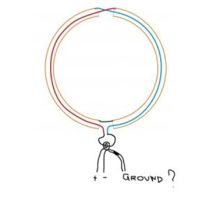

thanks
Barry (Australia)
Richo is that connection correct?
Stations: 1300, 1319, 1326, 1425, 1572, 1575, 2341, 2907
Reply
#26
thanks
Barry (Australia)
Yes  - That is right  Cool
Stations: 584, 585, 2017
Reply
