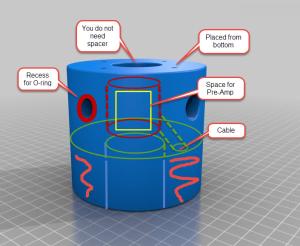

I have started making the H field Copper tube Loop antenna shown in your mini guide and also from http://users.skynet.be/DanielV37/Project...m#Hardware.  I have produced 3D print files for the top & bottom Junctions from the drawings on that site and have published these files at http://www.thingiverse.com/thing:1713141 .  I have included attribution to the design as best I could find reference.  Can you have a quick look at this url and advise if any further attribution is needed.
thanks

Have a lot of suggestions for changes - water intrusion is a challenge
By the way - time has run from this antenna - it is too large, and intended for System GREEN
Make it of brake tube 5-6 mm and a diameter of ~ 40cm

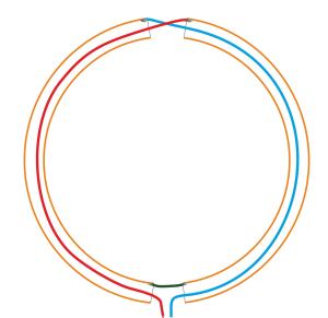

Most effective is the "Möbius" with transformer

I have a new System Blue (#1588) and have been testing H-field performance with a 2 axis wire loop antenna with 20 turns @ 38cm diameter (with the jumpers made on the back of the H-field antenna).
Can anyone comment on the relative performance between the simple loop antenna, and the ~40cm 'brake tube' möbius antenna that RichoAnd mentioned a couple of posts back?
Thanks,
Peter
Stations: 1588
Reply
#20
Minor difference if any
Stations: 584, 585, 2017
