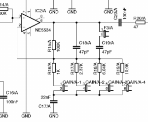

I seem to have a low gain on this system (Waregem, West-Vlaanderen). Can someone help me with the settings of the jumpers?

This image shows the jumpers who you can use to have more gain though Smile

I think your gain is set to 28.
Btw, I think you should power up the system by the controller.
Here are all gains available:
A1- A2- A3- A4 = Gain
0 - 0 - 0 - 1 = 11,00
0 - 0 - 1 - 0 = 17,56
0 - 0 - 1 - 1 = 27,56
0 - 1 - 0 - 0 = 43,19
0 - 1 - 0 - 1 = 53,19
0 - 1 - 1 - 0 = 59,75
0 - 1 - 1 - 1 = 69,75
1 - 0 - 0 - 0 = 101,00
1 - 0 - 0 - 1 = 111,00
1 - 0 - 1 - 0 = 117,56
1 - 0 - 1 - 1 = 127,56
1 - 1 - 0 - 0 = 143,19
1 - 1 - 0 - 1 = 153,19
1 - 1 - 1 - 0 = 159,75
1 - 1 - 1 - 1 = 169,75
(Thx Daniel from Hannut)
Enjoy!
Clément

I have changed it into this set-up. Better?

The gain is specific to each station. 28 is maybe good for you, my green station can go up to 53.
You should set it in a way that your stations doesn't go in interference.

(2015-05-17, 12:04)DelandeC Wrote: Here are all gains available:
Is 0 - 0 - 0 - 0 gain x1? Because I'm still receiving signals with no jumpers set, in the middle of a storm Big Grin

Yes it is Smile
