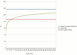

#4
There is no gain setting to cover both, far and close strikes:
You can change the gain setting for close strikes.
Though it is very difficult to find a good setting because of the enormous amplitude differences among the strikes, you will still miss a lot of strikes and record "noise".
