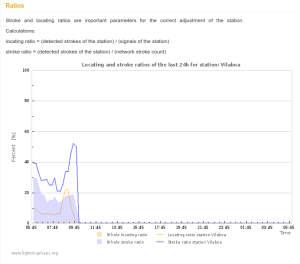

(2017-11-03, 12:55)Cutty Wrote: We define:
Goal: detect maximum number of strokes accurately with minimum number of signals
Efficiency: Ability to accomplish something with the least amount of time and effort.
Effectivity: Actual production of the intended result.
Efficiency = Strokes Detected / Signals Sent
Effectivity = Strokes Detected / Signals Sent - Strokes Detected

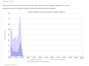

As you know I've been evaluating the above and have found it useful in tweaking my station to get the number of signals used high and the number sent low. This was proving quite succesfull. Today there is no lighting activity in Europe to speak of (the Europe static map had a count of 7 (seven) a moment ago). My station sample produced this:
As there is no lilghtining all the measures are zero, yet stations are still sending 1000's of signals/hour. This can really only be local noise. We could rename "Effciency" to "Waste" and invert the calculation trapping the divide by zero problem to return 100%. Trouble is everyone above is 100% wasteful which, while technically correct, isn't useful. Is there some way to have a meaningful "Waste" value when the Used count is zero?
Maybe an "allowable noise" number? (<Sent> - <allowance>)/<sent> trouble is if your under allowance you end up with a negative "waste".
Ideas?
Cheers
Dave.

Posts: 519
Threads: 18
Joined: 2016-06-09
(2017-11-24, 07:57)pasense Wrote: allsorts claims that there are many stations in region 1 are sending only noise.
A claim for yesterday only when there really was very little activity in Europe that I could find on other live lighting sites using other data sources. I looked at, and variations where offered :
https://www.weatheronline.co.uk/weather/...uro/DL.htm
https://www.netweather.tv/live-weather/lightning
http://en.allmetsat.com/images/lightning-europe.php
Egon has since said there was a server fault, fair enough, but lets not get distracted from trying to sort out better measures for station performance. The underlying reason for zero used signals isn't overly relevant what is relevant is that zero used signals highlighted a weakness in the current proposed "Effciency" measure.
An "allowance" doesn't really work, partly because of the possible negative percentage but also, and probably more importantly, the enviroment of stations varies greatly so a "one size fits all" allowance isn't really practical. Anything that involves averaging a stations sent count would mask the problem that we are trying to eliminate.
Do we need the "Effciency" measure at all? I'm finding the proposed "Effectivity" a pretty good guide as I make small tweaks here. How ever I do look at the "Effciency" as well.
Cheers
Dave.
