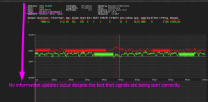

That sounds very good, I’m glad you helped me. Is it possible for me to also join the Europe region, while still remaining in Asia?
PS: Several hours have passed, but I still don’t receive any signal updates on the panel. During this time, the station has collected some Valid, Involved, and even Used signals, but none of them updated the signal display on the panel.
