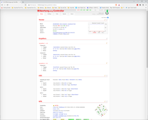

It looks like it has gone deaf. Carried out a reboot but not much happening.
Power LED on, Network LED on and GPS LED Flashing, that's about it.
Looking at the data received it appears something changed around 20 July. No local power disturbances or storms, Unit is fed from a POE switch via an adaptor and the whole lot is on a UPS...
Are there any bits of advice as to what I can do to diagnose what is going on?
Nothing showing in the debug log unless GPS and Web are selected...
Additional: Some info the the debug log, I do not think it makes good reading...
