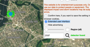

I have inserted a search funktion on the vector map. If you dont find your station on the map, try
http://map.blitzortung.org
-> Extended user interface
-> enter the station number
You will also get a reason, if the station is not on the map.
The station list of blitzortung.org still has some minor bugs concerning the assignment of regions that I will fix next.
/Egon
