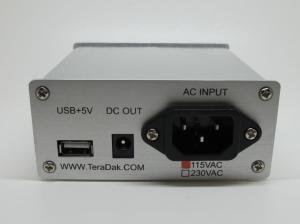

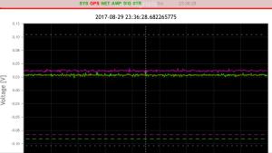

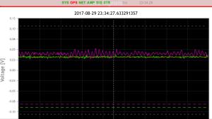

I just received a TeraDak U9 linear power supply to replace the iPad power supply I was using to power the Blitzortung blue board. It was a little costly, but it did cut down on the noise pretty good, as shown on the magenta E-field channel in the attached pictures.
I'm not sure if it really makes a big difference in accuracy of the system, but I'm pleased with the results.

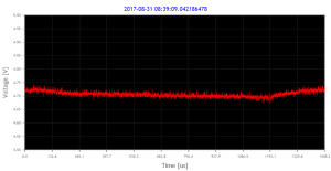

Can you show how the voltage signal from the power supply looks like?
Menu "Blitzortung.org Controller" -> "Signals" tab -> "Signal Tools" -> "Sampling:" -> "Channel: V_in"

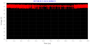

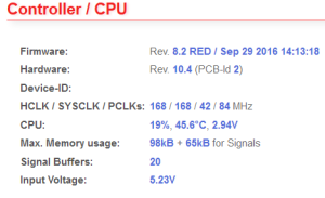

Here you go.
It seems lower on that than it does from the controller status page. I wonder why this is? Is this too low? Their website says output voltage is adjustable, but I'm not sure about that.

Thanks, quite nice graph Smile

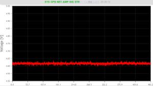

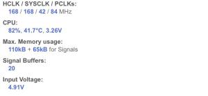

This is mine - terrible Angry (Scale of 0.5V - just like you).
Different voltages: CPU, Input Voltage.
Attached Files Thumbnail(s)

#5
At least you aren't under power, but I don't know if over is good either... I wonder if it makes any difference?
I found that the USB voltage can't be adjusted on the unit I got, but there's another DC output that can be. I tested that one, and it's 5 volts on the nose. I just need to get an adapter for the plug that will connect to a USB plug. (Already have one on order)

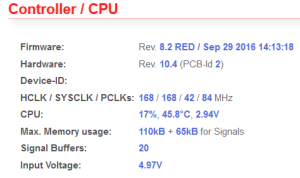

See the specs on that 1898.... the source input on my BLUE at 115V right now is showing 4.95 volts with DVM, signals page is indicating 4.55...   (i've a pre-release controller with piggy-back power supply mod board hung on... ).... My Red is on the button at 5.0 source, and 4.75 on signal page.

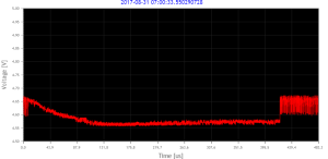

The previous chart is from the power supply Samsung 5V, 2.0A (from the Samsung Galaxy S2 tablet).
Below are charts from another power supply: Samsung 5V, 1A (from Samsung Galaxy S4 mini smartphone).
The voltage often jumps as shown in Figure 2. Despite this, this new power supply seems better.

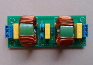

Is such a filter like that could help reduce the noise?
Or similar by home made.

If it really does have 80 mV of 50 kHz (+/-) on the output it might be too noisy for a blue controller. The TL-POE10R I use to power mine had about 100 mV P-P noise and the controller wasn't happy. The simple two toroids and capacitors filter cured that though reducing the noise to 5 mV P-P (if the V_in monitor on the signals page of a controller is to be believed).
