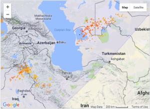

The system seems to be working very well. Yesterday there were many in the western end of Iran and the area where Turkmenistan, Uzbekistan and Kazakhstan all meet the far side of the Caspian Sea. That's 2,700+ miles (4300+ km). See attached:
  • Time range: from 2016-11-01 00:00:00 UTC to 2016-11-02 00:00:00 UTC
  • Count: More than 1000 Strokes found
  • Oldest: 2016-11-01 10:40:57 UTC
  • Newest: 2016-11-01 23:58:31 UTC
Participated strikes are marked with a large square blob with a light center, just detected are small round blobs. The shaded/unshaded is the boundary of the 3000 mile search radius. That map is a capture from my install of MyBlitzortung which I think only has strike information relating to my station.
I'm not sure I believe the few participated and other strikes that show up south of the equator off the coast of Congo/Angola! They are 4,200 miles (6,700 km) away... Is there a way to verify them?
