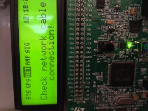

I have the RED system with version 7.4 which works fine. I wanted to move to version 8.1 but after 20 minutes there is no network connection and asked me to check the network cable. I tried version 8.0 and 8.1, the same finding, network problem !!!
Have you an idea about this failure.

After 18 minutes , all ok , look the photo.
tks

#5
There seems to be a memory allocation problem. It's not directly related to the network connection. I will investigate.
PS: Please leave the station running this way! Thanks!

after ten minutes, on the display: Check network cable connection... networks down...

#10
The problem occurs only when the station is registered for more than one region in combination with compression. It will be fixed in the next firmware.

#11
(2016-09-28, 06:55)Tobi Wrote: The problem occurs only when the station is registered for more than one region in combination with compression. It will be fixed in the next firmware.
Helle Tobi,
I just installed version 8.2 and it works great. Tobi thank you very much.
