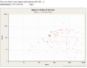

This is a good tool for helping to find a good balance, between signals sent and strokes recorded.
https://www.meteomelin.be/staticfiles/bl...gion=1&id=
The best stations tend towards the top and the left and the "worst" stations towards the right hand side and the bottom right corner.
This does depend on the conditions at the time and there will be some movement, however some stations appear to be consistently doing well within the middle area.
I hope that you find this helpful. I look forward to seeing a new station always, but the first one in India will be special.
Brian.

I like that plot, my station is currently nicely in the upper middle area. B-) And consdiering the nearest activity is 1500 miles away SE of Italy out over the Med not bad, it's not really trying hard either gains 10*10 threshold around 85 mV and noise around 35 mV. It's participated in 211/1000 strikes over the last 1h51m within 2000 miles. Drop the range to 1000 miles and it's 9/18 over 10h30m...

(2017-10-24, 06:00)readbueno Wrote: This is a good tool for helping to find a good balance, between signals sent and strokes recorded.
I like this one, but it's also a "slow" efficiency marker like all the others. But again we could take some lessons learned out of it. Close to the diagonal is good, far away is bad. I think that is a part of the current calculation already.

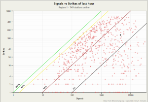

For 2.) Egons suggestions are good, but what about a quality measure for the signal used in calculations? For stations within the network (but ONLY for them), this appears to be a good indicator:
https://www.meteomelin.be/staticfiles/bl...egion=1&id=
In the case of the few stations contributing to more than one region the regions should be combined in the efficieny measure, but if the regions are going to disappear anyway, this may not be required.
For 3.) Stations within the network (surrounded on all sides by other stations within a reasonable distance) need to be treated differently from stations at the fringe of the network like coastal stations or even completely isolated stations (on islands, isolated towns...) Maybe one could calculate a measure that indicates the integration or isolation of a station?
From the experiency of the other network that operates globaly ( http://wwlln.net/) I would suggest to install the LN filters directly on the board since soldering the tiny ICs afterwards is really difficult. Wwlln uses a cutoff of 22 kHz since most of the sferic signal strength is below this frequency. If bought in quantity the cost of the LP filters is acceptable and the added flexibility in handling noise and improving S/N ratio is well worth it.

Hi All, We need to define what we each mean by "efficiency" and agree on a common definition?
In the case of:-
Would it be possible to develop this tool slightly more and have an average accumulated total for various longer periods, updating every five minutes and only giving the results for the last hour, whilst very useful, does not go far enough. One day, One week, One month?
This need not be "real-time" for the historic data and would show the affects over time, especially if several graphs could be seen on the same screen at the same time for comparison.
This "pattern" might also help with the station stats pages, i.e. more variable periods of time rather than just the last 24 hours, or the total stored data since the station started.

In the case of:-
Nice graph. I would add some reference lines for a better interpretation:
Luis. (Lugo, Spain)
Stations: 1831
Posts: 272
Threads: 9
Joined: 2017-07-18
Hi Luis, Yes I like that Idea. No-one is going to get near 100%. As we see, most stations are between your yellow and the black lines, that seems to be the "reasonable" area, although that should not discount stations in that area trying to improve!
The area to the right of the black line should be an indication that these stations are not working as well as they should/could, and that an effort should be made to improve this situation.
The nearer you get to the bottom right hand corner the more opportunities for improvement are open to you?
These stations are your Blitzortung neighbours, you should help, them just as you do your physical neighbours, when they need help.
Maybe the actual points could be made different colours to show the "health status" of the stations?

Hi Cutty, How does this look in your scheme of things. I am the third black dot a little to the right, yours is the top black dot and another Mike is just a little to the left of my dot.
Whilst I feel that I have, even yet, considerable "headroom" for improvement, my station appears to work quite efficiently when there is Lightning to report and sends very few signals when there is not.
I presume that some of those signals at least are "Housekeeping" between the station and the server? Rather than just wastage.
As a European coastal station added to Region 3, I feel that the benefit to both regions when there are storms in the North Atlantic are significant.
Maybe more coastal stations would consider this option in various situations?
I am also considering, some time over the winter, to have a dedicated antenna, with which to assist, if possible, the new stations in Africa.
As nearly three-quarters of my horizon is ocean it should be possible to "null" out most of Europe by careful positioning of the antenna, I was thinking of a single three turn Mobius type, and for this specific example, a certain amount of Dxing would be legitimate and beneficial to the development of the Network.
This use of a deeply nulled single antenna could be of use in various other situations as well?
Regards.
Brian.
