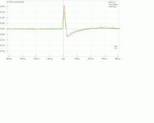

You sending a lot of disturbers :
Whats this ?  An electric fence ?
