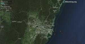

This is what Sydney area displayed at 1109 UTC today...
as well as the offshore activity up at Port Macquarie...
Perhaps most of your Sydney observations were not C-G strokes, the nearby stations were not collecting data as activity was too strong, and / or not enough more distant stations (>50km) were reading impulses to locate.
