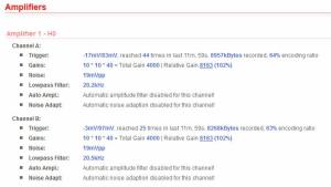

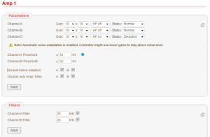

Yesterday I upgraded my System Blue PCB 19.3 with 2 filter IC's. Currently I'm playing with the configuration and settings and think this will take some days and different lightning situations...
I've disabled digital noise adaption in AMP1, applied and saved but there is still the warning: "Automatic noise adaptation is enabled. Controller might use lower gains to stay above noise level."
I do not use AMP2 (disabled) and don't have installed a filter here but there is also the same message.
SW is 8.3b2 and I'm in Manual mode. On the Sttaus page everything is OK.
