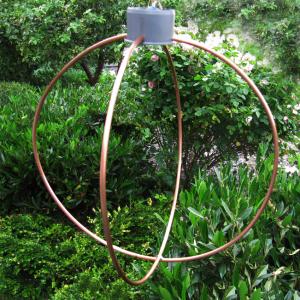

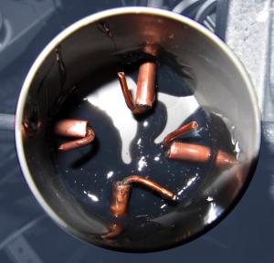

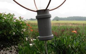

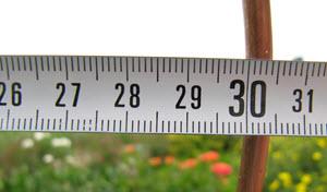

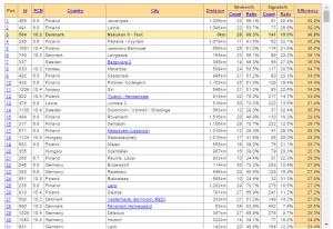

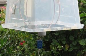

Yesterday I finished test of a new 30cm loop antenna
It performs better than my 90cm Möbius copper loop antenna for System RED.
I use the new Differential Preamplifier in front of a RED H-Field amplifier
