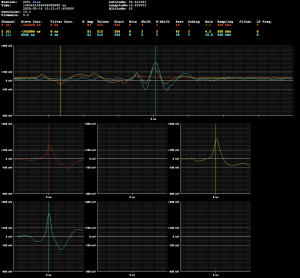

AaAH... back again
signal.php... confusion on System Blue... no issue for System Red:
Same color (yellow) set for channels 2 and 3 (a3, b1) or 3 and 4 below:
line_colors 1R,1G,1B,2R,2G,2B,3R,3G,3B,4R,4G,4B,5R,5G,5B,6R,6G,6B (default: 255,0,0,0,255,0,255,255,0,255,255,0,0,255,255,255,128,0)
Also... can't change the line colors
haven't tried any other parameters on signal.php

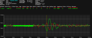

#29
If you set the background to transparent, there is a little issue with the header text (part that is white disappears)
add an extra modifier to set that to black or other colours ??
Attached Files Thumbnail(s)
Reply
#30
(2020-04-13, 07:43)Eric.Wouters Wrote: If you set the background to transparent, there is a little issue with the header text (part that is white disappears)
Eric, the 'transparemt will show the background color of the element (body, cell, div, in which the lies.  If the background is white, then the white of the text will 'disappear'.
Egon fixed the channel trace color for Ac and Ba ((2,3) on signal.php.

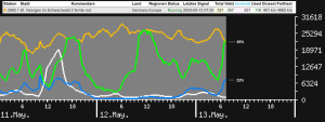

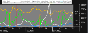

Hello Egon,
I've some doubts regarding the statistics_1 diagram.
1) Does the description of the line colors match the values used for the calculation?
There are four lines in the diagram:
- signals (max = n)
- strikes/signals
- involved/strikes
- used/involved
There are two scales at the diagram:
- left hand percentage form 0% to 100%
- right hand signal count from 0 to n
Thus I expect the right scale to be valid for the signals graph amd the left scale with the percentage to be valid for the three other graphs.
At UTC 2020-05-10 18_29 I took a snapshot of the statistics_1 diagram and of the satitons list figures.
Based on the pixels I calculated the percentages in the graph and based on the figures I calculated the expected percentages. They differ greatly.
The percentages sudenly start to match, when I chose different calculations.
valid/total = 11986/20887 = 57% = yellow = 69px/121px = 57%
involved/total = 5440/20887 = 26% = green = 32px/121px = 26%
used/total = 2208/20887 = 11% ~ blue = 14px/121px = 12%
Is this just coincidence or is the legend partially wrong?
yellow is documented as strikes/signals, but it seems to be valid/total
green is documented as invlolved/strikes, but it seems to be invlolved/total
blue is documented as used/involved, but it seems to be used/total
2) There are sudden drops ot the green line to zero. See May 8th 9am, May 9th 1pm and 6pm, May 10th 8pm.
I'd possibly understand this if there would be interference and the station would suddenly send only unusable signals, but there was no sign of a malfunction.
The most extreme example is at May 8th 9am.
For more than two hours all valid signals have been also regarded as involved signals.
Then in the next moment zero of the valid signals have been involved.
How can this behaviour be explained?
Klaus

#33
Hi all,
I had little time to take care of it, I will look at the problems and check everything.
Regards.
Egpn
Stations: 3071, 3073, 3074
Reply
#34
I have another example with the same results at UTC 2020-05-10 07:04
valid/total = 357/521 = 69% = yellow = 83px/121px = 69%
involved/total = 357/521 = 69% = green = 83px/121px = 69%
used/total = 118/521 = 23% = blue = 28px/121px = 23%
Stations: 2065, 2398, 2729, 3058
Reply
#35
You are right, the calculations of the curves were not correct. I corrected it, please check.
I'm still working on the time zone problem.
/Egon
Reply

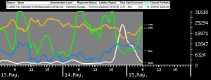

UTC 2020-05-15 05:45
The persentages seem to be ok:
valid/total = 885/1278 = 69% = yellow = 83px/120px = 69%; The diagram uses the deviating name strikes/signals.
involved/valid = 672/885 = 76% = green = 91px/120px = 76%; The diagram uses the deviating name involved/strikes.
used/involved = 178/672 = 26% = blue = 31px/120px = 26%; The diagram uses the identical name used/involved.
The total signal count appears to be too high. This is valid for all samples I took.
max signals = 31618
total = 1278, white = 7px/120px*31618 = 1844
The terminology is slightly different between the https://map.blitzortung.org/statistic_1.php diagram, http://de.blitzortung.org/station_list.php and the table view on LMO https://www.lightningmaps.org/blitzortun...n_id=14972:
- "signals" in the diagram corresponds to "total" in the station list table, which corresponds roughly to "Signlas/h" on LMO (a factor of 2 has to be regarded).
Thus "signals" and "total" can be regarded as synonymous.
- "strikes" in the diagram corresponds to "valid" in the station list table. But "Strokes/h" on LMO corresponds to "involved" in the station list table.
The difference between "valid" and "involved" needs clarification. In different context both are named "strike/stroke". At the moment I assume LMO is right.
Here: https://forum.blitzortung.org/showthread...e#pid21010 Cutty explained the sieve which is applied to filter the valid from the total signals by means of some quality criteria.
Quote:The server computes a 'noise level' for a specific channel's signal, on the first 25% of the 'impulse group" analysis time window (1000ms)  (beginning 500ms before 'trigger')
and will REJECT, that is "Not Consider" a signal whose Trigger Voltage is NOT 3 times that computed noise level.  (that channel selected will be coded "valid" on the BLLITZORTUNG.org  Signal images (or at Sferics US   for "Americas Rergions" stations only LIVE SIGNALS ... "A "valid"channel will move into consideration for "locator"
A signal which meets the above defined quality criteria doesn't automatically qualify to be a stroke. The "locator" has to decide whether the signal actually belongs to a stroke. I assume the "involved" signals did pass the "locator" sucessfully - and thus they qualified as strokes.
