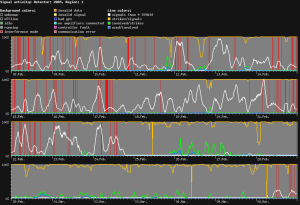

Hello Egon,
many thanks for the statistics diagram. In general it works quite well, but at the moment the four weeks are full, there seems to be old data displayed in the newest day.
I took a screenshot today at 6 AM and found data being displayed for the entire day until midnight. See the bottom right corner of the diagram, the time vexong 6 AM.
Cheers
Klaus

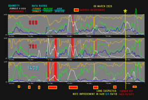

past wk

Wow! How much of that was done in a graphics editing program? I'd like to see my stations automatically displayed on the same page like this!
Regards,

Like This?
https://frankfortweather.us/frankfortblitz/

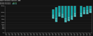

Hello Egon,
I've two questions to statistics_2b.
1) Would it be possible to show distances beyond 5000 km in the diagram?
2) The minimum distance printed top left of the diagram matches with the bars. The maximum distance in the bars shows higher values than the one printed top left. What is the meaning of the maximum distance and why is there a difference?
Klaus

Hi folks,
the minimum and maximum distance now relates to the days displayed. I'm sorry about the bug.
The distance scaling can now be set individually, but it remains exponential to the exponent 1/2.The scaling can now be set individually, but it remains exponential to exponent 1/2. The specified values must be greater than 0, ascending, and separated by commas.
Here is an example with distance_labels=10,50,200,500,2000,5000,10000:
https://map.blitzortung.org/statistic_2b...5000,10000
with labels_extension=1 the last label is the maximum of the last label and the maximal distance.
https://map.blitzortung.org/statistic_2b...xtension=1
Further suggestions for improvement are welcome. I am currently working on a direction image for the received signals of lightning strikes.
I have moved the scripts statistic_1b.php and statistic_2b.php to statistic_1.php and statistik_2.php, even if the new database only contains 13 days now.
/Egon
