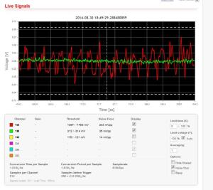

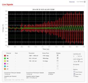

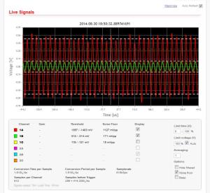

However, today, there were some thunders within acceptable range and I saw relative close stations (40-50 km) receiving strokes. I decided to look at the Live signals that are visible by accessing the controller via IP.
I noticed "strange" behaviour of signals displayed as they looked like an almost perfect sinus and random noise should not look like that. I have attached 3 pictures showing the signals and when I manually turn the antenna I can "beam" the signal or not. Actually I was expecting that the "noise" on channel 1A would disappear and appear on channel 1B when moving the antenna around.

The self oscillation, as suggested by Richo Andersen, was already ruled out before sending my initial post. With more than 30 years experience as a hardcore builder of antenna's, transceivers, receivers and high power RF-amplifiers I do have experience tracing self oscillation in build configurations. It was clear that what I was seeing was man made noise / interference.
After a days rest I realised that I did not have enough background to analyse the live signals I was seeing when accessing the system through IP. Understanding what I was seeing should be the solution. So I started if I could find examples of live signals from a working RED system as there are none given in the manual. On www.wxforum.net I found a topic on Interference and Noise with some screen captures from interfering signals and they gave very good information how signals should look or should not look like. And.. the pattern what I had seen and interpreted as not good was there too.
It became clear to me that the system is way more sensitive than I expected. Moving the antenna through the house it's easy to get it into interference mode by getting close to the TV and other electronic stuff. The signal I was seeing comes from my neighbour and it switches on and off with his laptop computer. I'm convinced that his laptop will not be a problem any more when my antenna is looked outdoor about 20 meters over ground level.

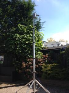

As the weather improved it was time to get the antenna outdoor. For testing I'm using an old telescopic aircolift from which the platform is removed. Just 3 meters high but very handy for testing antenna's.

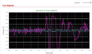

The quality of the received signal improved at lot, even when the antenna is still surrounded by houses. But now received thunder strikes are clearly visible and the ground and sky waves are recognized. The returning pattern still shows interference, most likely nearby solar panels but that has to be investigated in the near future.
Next step will be adjusting the amplifier to the best gain level and then the antenna will be placed in my antenna tower at 20 meters groundlevel.

PA4EME: I see that you have connected the antenna to channel B. Waveform colors - blue and purple. Normally it should be connected to channel A - this is a recommendation.
