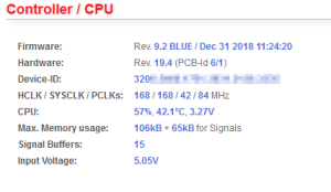

RE: Station Isn't Recognized. Not on List. ETC - dupreezd - 2020-08-12 (2020-08-12, 18:03)Slavkowski Wrote: User name: slavkowski (2086)Status updated RE: Station Isn't Recognized. Not on List. ETC - Slavkowski - 2020-08-14 (2020-08-12, 18:18)dupreezd Wrote:Thanks.(2020-08-12, 18:03)Slavkowski Wrote: User name: slavkowski (2086)Status updated Is there a chance you give me a hint about my first problem? I tried to tied my station(Processor-ID) to my account but still it didn't work. RE: Station Isn't Recognized. Not on List. ETC - dupreezd - 2020-08-14 (2020-08-14, 08:14)Slavkowski Wrote:Did you plug your controller Device-ID number, (Connect to your controller and scroll to Controller/CPU)(2020-08-12, 18:18)dupreezd Wrote:Thanks.(2020-08-12, 18:03)Slavkowski Wrote: User name: slavkowski (2086)Status updated into the Processor-ID field of your BO profile? Just the numbers, no dashes (-). RE: Station Isn't Recognized. Not on List. ETC - Slavkowski - 2020-08-15 (2020-08-14, 12:49)dupreezd Wrote:Yes, I tried several times put Device-ID from Controller/CPU to "Assign a new Station (Processor-ID) in my profile. Every time I got notification that Processor-ID has been added. But i don't see any changes. Still my station is no assigned.(2020-08-14, 08:14)Slavkowski Wrote:Did you plug your controller Device-ID number, (Connect to your controller and scroll to Controller/CPU)(2020-08-12, 18:18)dupreezd Wrote:Thanks.(2020-08-12, 18:03)Slavkowski Wrote: User name: slavkowski (2086)Status updated RE: Station Isn't Recognized. Not on List. ETC - micha.d - 2020-08-16 @Slavkowski / dupreezd: May I suggest that you continue in another thread about the connection problem? Due to a previous discussion already my request seems to be lost, so I'll repeat: User Name: lt.ning Station Number: 1974 Region: currently Asia, Oceania
RE: Station Isn't Recognized. Not on List. ETC - Slavkowski - 2020-08-16 (2020-08-15, 14:48)Slavkowski Wrote:(2020-08-14, 12:49)dupreezd Wrote:Yes, I tried several times put Device-ID from Controller/CPU to "Assign a new Station (Processor-ID) in my profile. Every time I got notification that Processor-ID has been added. But i don't see any changes. Still my station is no assigned.(2020-08-14, 08:14)Slavkowski Wrote:Did you plug your controller Device-ID number, (Connect to your controller and scroll to Controller/CPU)(2020-08-12, 18:18)dupreezd Wrote:Thanks.(2020-08-12, 18:03)Slavkowski Wrote: User name: slavkowski (2086)Status updated Update: I solved this issue by assigning my station to newly created user using link on BO controller page. (I'm aware that it was against the advise from BO, but this solution worked fine and my station is finally assigned). RE: Station Isn't Recognized. Not on List. ETC - Rejean - 2020-08-16 User 1968 (Rejean) Station 2521 Region: North America, Canada, Ontario, Whitby Station no longer appears as active / participating Note: There may be 2 database entries. The original active one showed 2 ferrites, and latter one E-Field only. H-Field preamp fried and only using E-Field now for moment. RE: Station Isn't Recognized. Not on List. ETC - malyan - 2020-08-18 Station 1684 Why is the Asian listing displayed? How can you remove Asian? Leave only European? RE: Station Isn't Recognized. Not on List. ETC - cutty - 2020-08-19 (2020-08-18, 14:53)malyan Wrote: Station 1684 (2020-08-19, 15:09)cutty Wrote: This question keeps repeating...already answered at least once in this thread alone: RE: Station Isn't Recognized. Not on List. ETC - Rejean - 2020-08-25 (2020-08-16, 23:34)Rejean Wrote: User 1968 (Rejean) Should I go to the https://www.blitzortung.org/en/user_data.php site and delete my data and re-register my unit ? I'm in middle of major lightning here, but the graph there shows nothing since end of July. Even though my H-Fields are out, I have E-Field working which is suppose to be sending. On the https://www.lightningmaps.org/blitzortung/america/index.php page, i see two entries for my station 2521. The one which has my E-Field 24inch shows some graph, but it is not coming from my station. Any suggestions to get me back on again ? ----------------- UPDATE Aug31-2020 : Got stuff working again !!! I replaced the 3x THS4531 chips on the H-Preamp, (these got fried somehow and only had E-field working), and I started getting H-filed signals again at the controller. I emporarily disabled the "Need Authentication" and enabled the "Guest" on the controller's web interface. I then logged into the blitzotung.org site, and again added my device ID. Yeppie !!! the web page portion to enter antenna info etc now appeared. I entered the info, changed Anonym from Y to N, saved it, and then presto ... my controller now shows my user ID which it didn't earlier. Things now appear to be somewhat back to normal. User 1968 (Rejean) Station 2521 Region: North America, Canada, Ontario, Whitby RE: Station Isn't Recognized. Not on List. ETC - koleto - 2020-08-26 User: Koleto Station Number: 2776 Region: 1 - Europe Station Number NOT associated with my User ID Tried several times to assign my new station (processor ID) in my "user data" page under Project Area section on blitzortung page with no luck and I need your help. Thanks ! Kind Regards, Koleto RE: Station Isn't Recognized. Not on List. ETC - dupreezd - 2020-08-26 (2020-08-26, 18:39)koleto Wrote: User: KoletoDid you get a second station? This says Station number 2776 but you already registered station 2757. RE: Station Isn't Recognized. Not on List. ETC - koleto - 2020-08-26 Hi dupreezd, Yes, this is my second station. The first one is 2757. Both are now active though in one and the same location, but I am planing to move one of them to another place soon. Kind Regards, Koleto RE: Station Isn't Recognized. Not on List. ETC - Barsanu - 2020-09-23 User:Barsanu Station: 2755 Region: Europe RE: Station Isn't Recognized. Not on List. ETC - dupreezd - 2020-09-23 (2020-09-23, 12:34)Barsanu Wrote: User:BarsanuStatus updated RE: Station Isn't Recognized. Not on List. ETC - Barsanu - 2020-09-25 Please see post #1 regarding posting in this thread - Admin RE: Station Isn't Recognized. Not on List. ETC - Barsanu - 2020-09-29 (2020-09-23, 16:02)dupreezd Wrote:Stations have two entries in the station list.(2020-09-23, 12:34)Barsanu Wrote: User:BarsanuStatus updated RE: Station Isn't Recognized. Not on List. ETC - SGJones - 2020-10-04 user name = SGJones station number = 2822 region = Europe RE: Station Isn't Recognized. Not on List. ETC - Art_Brown - 2020-10-05 Art_Brown 2285 California, USA Station Not Listed. Thanks!! RE: Station Isn't Recognized. Not on List. ETC - David-T - 2020-10-14 Hi, I don't seem to have managed to link my forum account with my blitzortung project account... User Name for Forum: David-T Station Number: 2842 Region (Europe, Asia, etc.): Europe Problem: Forum operator status not upgraded Thanks, David |
