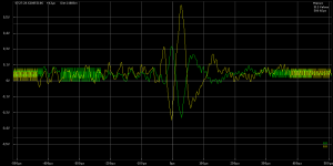

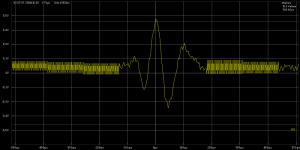

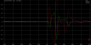

RE: Efficiency - pasense - 2017-11-01 Brian, you are right, the signals go in saturation for these strokes, but these were actually the strongest signals I have seen so far, so I copied the signal traces. I am just experimenting in order to see if and how I can get also polarity information from strokes over the ocean (which is supposed to be difficult or impossible), but yes, I could reduced the gain of the H channels. Coming back to useful plots we would like to have: a histogram of maximum signal strength, both for signals sent and for signals used in strokes would make it easy to spot such situations: these would just go into the "overflow" bin. So far, I have to look at the list of strokes in order to find out if the amplification and thresholds are OK. Such histograms are standard in all situations where one has to adjust such parameters and I am sorely missing these here! RE: Efficiency - cutty - 2017-11-01 Heh .... and here's what happens when you have 33 strokes >500 km but a sporadic noise maker active,which does NOT trigger interference mode,.... 83335 0 0% 0 0% 33 0% ...sigh.. sta 1439 1300UTC RE: Efficiency - readbueno - 2017-11-01 Hi All, Stupid question time? https://www.lightningmaps.org/blitzortung/europe/index.php?bo_page=archive&bo_show=strikes&bo_station_id=14853&bo_datetime_start=2017-11-01+11%3A50&lang=en&bo_strike_id=101230862&bo_other_graphs Looking at the signals on this page there is obviously a lot of variability in signals even for the same stroke. If you look at the stations chosen for location nine of them are greens, six are reds, and five are blues. Some of the signals seem vastly over-driven, being cropped flat topped and distorted, some with various amounts of noise and some that are barely recognisable as lightning at all? After looking at several pages like this I came to the conclusion that the criteria for being chosen for the location of strokes has nothing to do with quality of signals, but is just based on the first to arrive at the server. Greens send less information, so they predominate. Blues with H.O. or E.O. Send less info but more than greens or reds so they bring up the rear. there are very few 3 or 4 channel blues represented in this lottery? Yes, this is all just for one stroke! I have not edited it in any way. The chosen stations are underlined. My question involves the timing in micro seconds at the top of each graph at a quick scan this varies from a few + microseconds up to several + hundred microseconds, the average being +50-+60 microseconds! Only the fastest are chosen! Does this timing have anything to do with the decision about whether your signal is chosen for the location calculations? Based on my short observation it seem to. Secondary question. Is there anything that an individual station could improve on this time delay? Reduce channels and get a better result in the lists Are there things that we should avoid doing that might increase this delay? Send good quality signals on all channels? Last question, at least for the moment. Is this timing of great importance or is it the time that has the seconds to nine decimal places that is the important time? I wish I had studied statistics more when I was young, and I wish there was a quicker way to get all this data from the archives. Regards, Brian. @ Cutty mutual vigilance is the key!

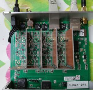

RE: Efficiency - micha.d - 2017-11-01 (2017-11-01, 07:52)pasense Wrote: @micha.d, Hi pasense, I have read that channel A has more noise due to the GPS being close by. So I switched to B and C for testing. I now feel that it does not make much difference, at least with my antenna getting some interference from outside and NOT over the PCB itself. Even soldering a shield into the device did not make a difference: But regarding the evaluation of separate channels I have some doubts. I'm also sure that single channels are used for strokes but signals coming in the direction of one of the two antennas seem to be prefered because there is a better chance to exceed the threshold. I think I can see that effect in one of the diagrams (https://www.lightningmaps.org/blitzortung/europe/index.php?bo_page=statistics&bo_show=longtime&lang=en&bo_station_id=14731), but it's most probably still to few data. My antennas are oriented in direction north-east <-> south-west and south-east <-> north-west and I think the green ratio is better in those two directions. To remove this effect we would need some info on the direction of the single antennas to calculate the direction of the signal source and effective signal of that direction. In my next live I'll go for 3 antennas to reduce this side effect. EDIT: Before someone complains. I mixed up some numbers. The link above is not my station. But I stick to 3 antennas in the next live. Back to efficiency ... RE: Efficiency - micha.d - 2017-11-01 I would like to bring the attention back to the title: Efficiency I have one more very very general observation that I would like to present. Having a value in % in my eyes must mean that the value is in the range 0 - 100. This is the case for the "Effectivity" on http://de.blitzortung.org. It is not the case for the "Efficiency" on https://www.lightningmaps.org. Values like "< -999%" are obviously a bit "special". Formulas like a/b - c/d or a/(b-c) cannot generate a % value. --> So either use % and stick to the range 0 - 100 or please just name it differently. RE: Efficiency - allsorts - 2017-11-03 (2017-10-30, 22:44)Cutty Wrote:(2017-10-30, 21:06)allsorts Wrote:(2017-10-26, 21:03)Egon Wrote: I would like to change the measure for the efficiency of the stations. Hmm, whilst I agree that a stations enviroment and location affect the settings (threshold/gain etc) of that station my gut feeling about the above formula is that distance "cancels out". ARGH! I hate web based editors that drop your carefully crafted message in the bit bucket if you accidentaly load another page in the same tab/window. I'd typed in a load of thought experiment showing that distance doesn't come into the formulas. It also showed that gain governed range and that threshold is best set after the gain/range value to the point where local noise only rarely triggers a signal. Note this was a thought experiment in a nice friendly world not the hostile, real, one. Finding a setting for the threshold with variable local noise levels might be tricky.The range a station is optimised for is a choice for the operator but for most benefit to the network ought to follow that relatively isolated stations go for range and ones with nearby neighbours restrict their range. RE: Efficiency - allsorts - 2017-11-03 Cutty: Efficiency = Strokes Detected / Signals Sent Effectivity = Strokes Detected / Signals Sent - Strokes Detected Has anyone used the above on real numbers? Recent grab from the stations list of my station (1627) and the three closest others: Sta Sent Used L Eff Eft 1690 1240 184 14% 15% 17% 1627 274 71 11% 26% 35% 1645 1714 180 10% 11% 12% 1620 1395 140 10% 10% 11% L : Current Effectivity L (S and M where zero). Eff : Used/Sent Eft : Used/(Sent - Used) Hey, I like this new measure. B-) RE: Efficiency - readbueno - 2017-11-03 (2017-11-01, 18:16)micha.d Wrote: (https://www.lightningmaps.org/blitzortung/europe/index.php?bo_page=statistics&bo_show=longtime&lang=en&bo_station_id=14731),ATTENTION!!! Hi All, Whoever the above Station does belong to. The gain settings are wrong, there appears to be an extra 0 on the 10 making it 16*100 on both channels shown! My views on high gains are well enough known. Whilst this is obviously a mistake, I think this station is still trying to use far too much gain! I have yet to see a situation where anything over 10 was useful, except for generating problems and extra signals that are not lightning. If you are one of these stations that insists on High gains and low thresholds, Please, Please try out very reduced gains, these boards are extremely sensitive and already well below the ambient noise floor in most situations, therefore increased gain only equals reduced signal to noise ratio, splatter caused by overload mixing products and other problems. Spread the word! Make someone your Buddy, you help them and they help you, and when not much is happening you can "chat" via email to someone that understand what you are talking about. Regards, Brian.
