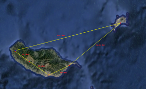

My idea would be to install maybe 5 station along the main island and another one in the neighbour island, Porto Santo. Please see the attached map. I work for the Madeira Electricity Power company and i have access to facilities (substations) across the island, and we are interested in doing some experiences with your system.
Please give me some feedback regarding the proposed configuration and the kind of results we should expect from it.
Note: most thunderstorms are expected to come from the west and we would like to see them coming in advance.

Yes, such a constellation would be possible. However, especially in western direction the opening angle will be very small so the detection efficiency will not be optimal even very close to the western coast. But strikes in general will be visible, especially with help from stations far away, like Richo already mentioned.
