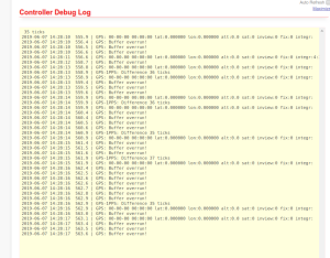

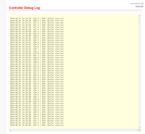

Hi All, I have a similar problem.
This appears to be something to do with the GPS Antenna. The red GPS blinks without the antenna and with one antenna I get sat data, but no pps and with another diferent antenna, pps data, but no sat data.
Apart from this the board appears to function correctly and it updated firmware with no problem.
I would like to get active again, but without further information about why this is happening I can not just keep buying different GPS Antennas until I get one that works.
Thank you in advance.

Hi Again, The Coax on the GPS antenna is an unknown mini-coax and the output from the GPS module is only 3.2 volts.
The power supply is adjustable and it is set just where the CPU voltage measures 3.25 volts this is, on this board, about 5.1 volts.
The voltage at the e field pre-amp is the same more or less as the input voltage.
The GPS Pre-amp says 3 to 5 volts working, but it is limited by the GPS module itself.
What is more of interest is why something is causing the buffer over run, that does not permit both functions to happen at the same time?
I have ordered the original cheapy eBay GPS antenna again, 3 weeks wait? As it did work until the landscaper weedwacked the cable! Angry
For the other two antennas that I got to replace that one, I went a little more up-market and neither of them appear to work?
This would normally point to the problem being somewhere else, but as far as I can tell the board is not showing any errors, except when a GPS antenna is plugged in.
Brian. 1856 Vilaboa
