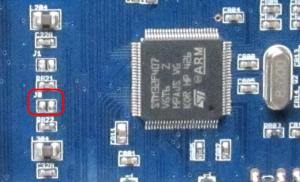

Today I installed the filters and jumpered J0.
The guide says you can adjust the filters, but I do not see anywhere to do this.

#16
Sorry for interrupt. Could anyone spot the j0 jumper on new blue(green board)?. I cant see it so far. (Or i need a new pair of glasses Tongue)
Stations: 1300, 1319, 1326, 1425, 1572, 1575, 2341, 2907
Reply
#17
Shy ...................
Attached Files Thumbnail(s)
Stations: 584, 585, 2017
Reply
#18
Thanks Richo. I allready order a new pair of glasses.. Wink
Reply
