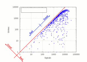

I played a little bit with the "new" efficiency :
Creating a small script which shows it in a 3D-diagramm. It's updating every Minute. Good performing stations are in the middle.

I am puzzled  I'm trying to get optimal results, and I use the participants page for checking the results. For what I understand the signals-rate is used in the calculation. So how can it be that one station has about double the signals, and less strikes be higher in the ranking? This would mean that sending more signals, and record less strikes is better...
But I could be missing something...

I'm interpreting it this way: if there are only few strikes in your range (50, 500, 5000), it isn't affecting the efficiency much, when you have a lot of signals.
There is no optimal setting for all eventualities. I think if you're in the two-figure-number efficiency, it's all good
